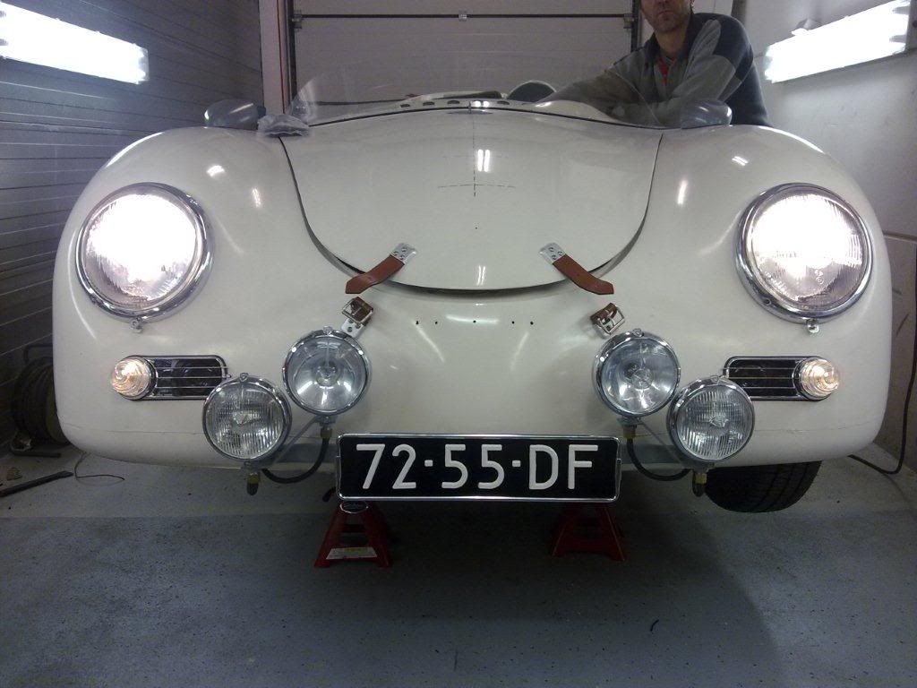

Postby &1 » Sat Oct 23, 2010 12:41 pm
Rome-Liege-Rome, les douze heures de Huy, Carrera Panamericana, les 24hrs du Mans; all races and rally's where also was raced in the dark...
In those days the cars had additional light (driving lights and fog lights) mounted at the front.
that looked like this:
And so I made a bracket to replace the bumper where the fog lights and driving lights could be mounted on:
Then I mounted the bracket on the car:
And then I mounted the lights:
The additional lights are time-correct Marchal's (like the ones that alse were used on for example the Ferrari 250GT)...
The driving lights:
The fog lights:

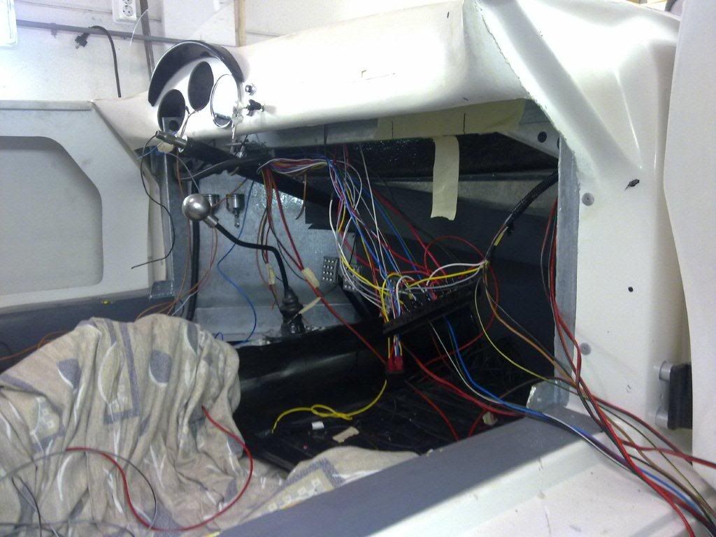

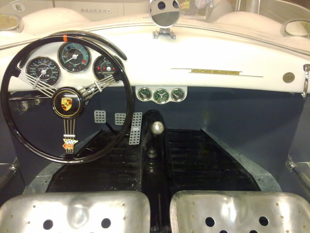

I made a holder for three extra gauges: a volt meter, a clock and a oil pressure gauge
Some extra 'racy' holes in the doors:
Then we started with the electrics (we used the color scheme of a Porsche 356C):
And then... In the end... It all worked!!!
We used an original fuse box:
And then when it all was connected, and the ignition lock and start button was fitted:
It was time to start the engine for the first time:
